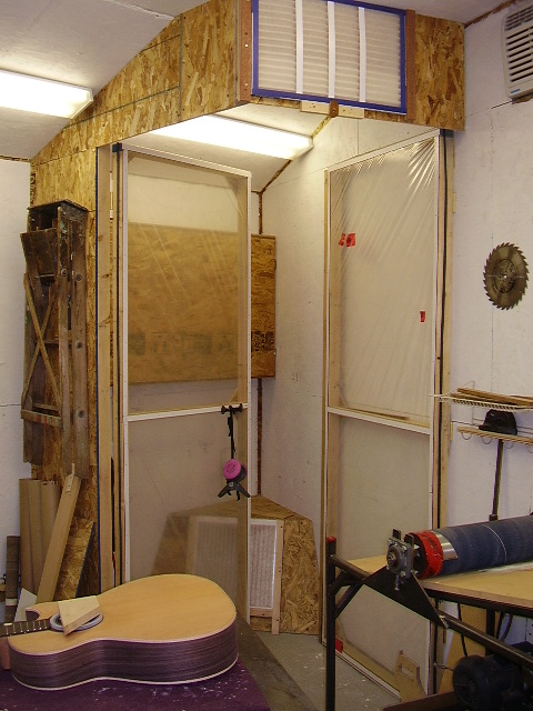

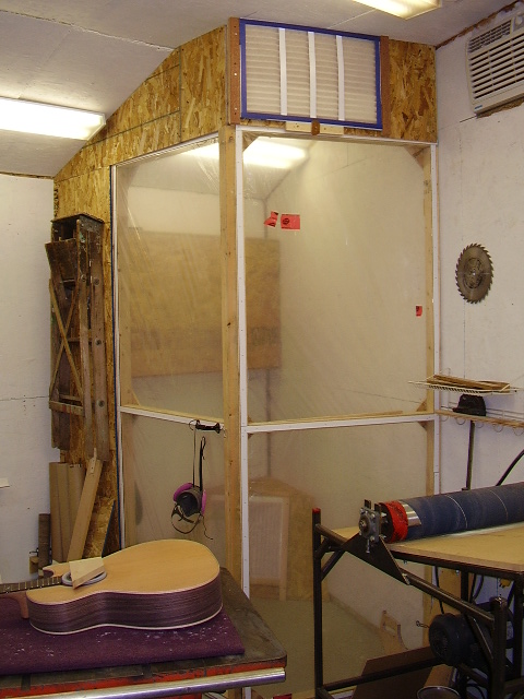

Well, here are some pics of my humble little spray booth, it's not totally up to code (I don't have explosion proof lighing, just one twin tube florecent lamp) but the fan is explosion proof.
So I have been saying in some previous threads that I have made a semi-knock down spray booth. Well the "semi" part is the two doors which swing into the walls. This still gives me room to use my sander.
Now with the doors open

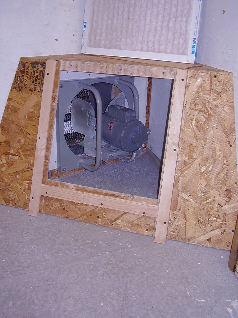

Here is the fan housing I made

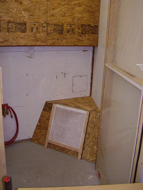

With a high end furnace filter to trap most of the overspray (ya right).
And the inside of the housing is the explosion proof fan and the exit hole.

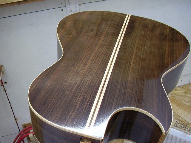

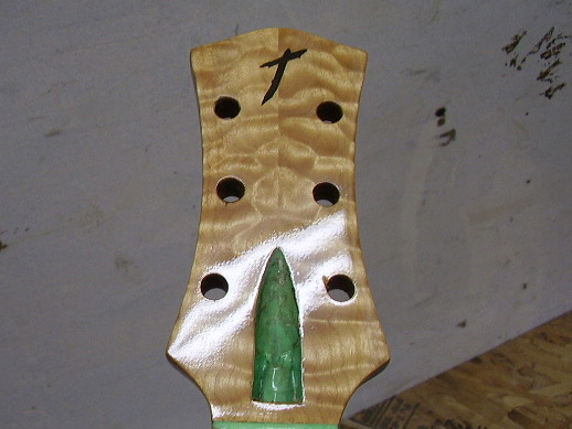

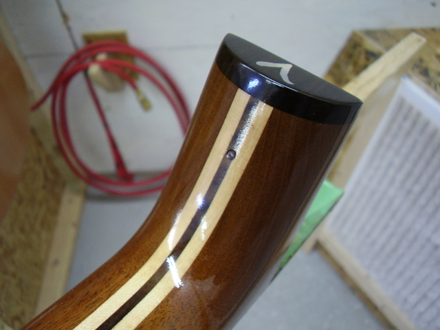

And some shots of a guitar being refinished (this is #3, and the first finish realy sucked, this one has 6 coats of nitro, a couple more than it'll be ready to level I think)

Joe, I don't have one of the electric trading company fans, I have one similar, it's a leason brand, 16" dia, rated for 2800+/- cfm (I think, It's on the housing, I'll recheck later). This thing realy works well for my little spraybooth, anthing bigger (booth that is) and I'd need a bigger fan I think.

That is a very nice set up. I was thinking more along the lines of the knock down setup that Jeff Jewitt has in his finishing book. Nice job! Are the doors more to keep the dust out or do you think they are necessary to keep the fumes in?
Joe
PostPosted: Sat Feb 04, 2006 5:38 am
Great set up Rod and gorgeous guitar too!
PostPosted: Sat Feb 04, 2006 7:01 am
Joe, the doors do both, or at least that's the idea, there is very little dust problems when spraying at this point so I think the doors have sealed alright. I leave the fan running for about 10-15 mins after spraying so the initial fumes are mostly exhausted. But of course, there is still off gassing so I have been keeping the doors closed and the rest of the shop is mostly fume free. Turning the fan on periodically to clear the fumes from off gasing.
